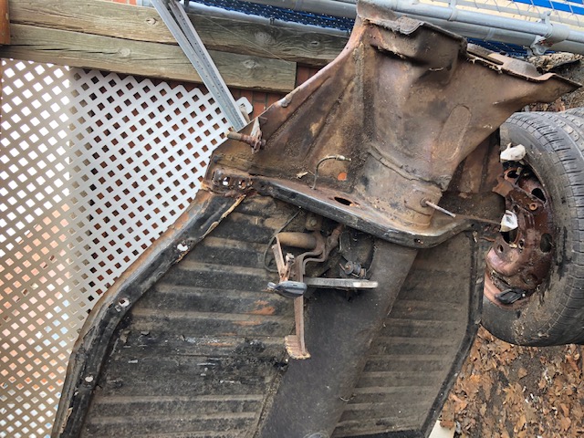

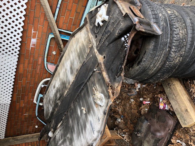

Re: 68 beetle class project
Some pics of the chassis. Pans are nice. Have to graft a section of Napoleon hat.
