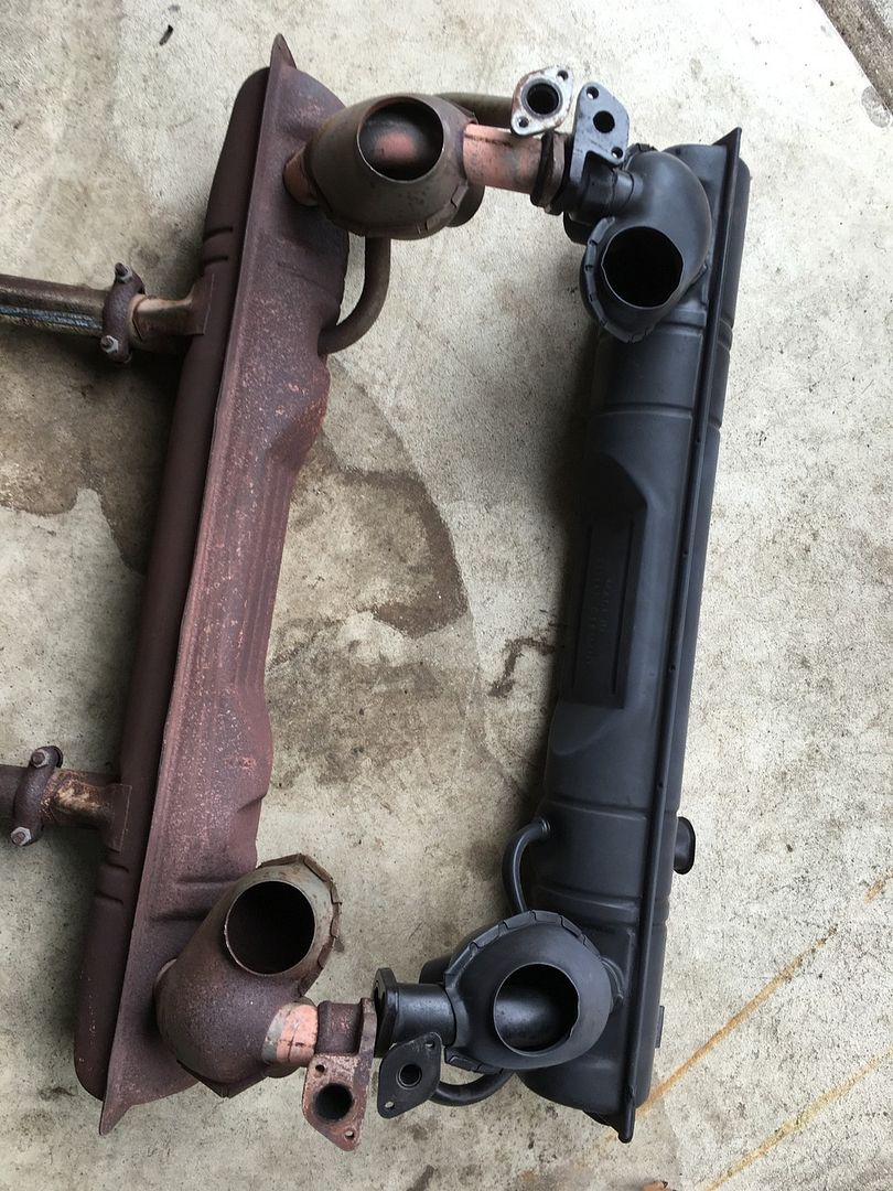

So got a few moments Late Sat night to yank the motor and swap the clutch disc. The old disc def was warn, but, honestly, I have seen and driven on with no issues, much worse. As far as thickness, it looked very close to the new one. Oh well, swapped it out anyway. Didnt get to drive it too much on Sat, and had to adjust the clutch a few times Sun during the inital test so something much have changed. I was able to at lease hit all 5 gears... but its def not like butter.
I'll check the coupling, shifter, guides etc as recommended next.
Sunday, logan and I swapped the mufflers. Oh well, it was a great day out and my buddy had a great time wrenching on the old girl.
fail.
muffler is for the smaller 1200cc 40hp
fail.

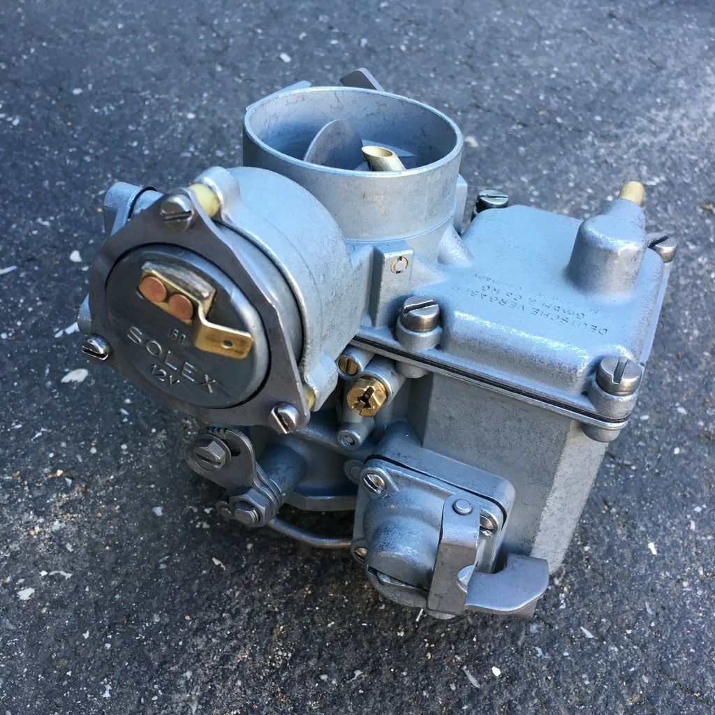

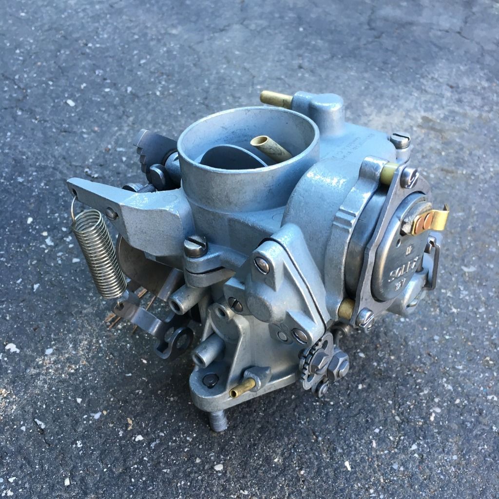

Been fighting with the idle in this for some time, so I tried a rebuilt carb off a new to me vendor. After a few snags, Im happy with this.
Been putting some light miles on it. Mostly grocery shopping. Went to pick dinner etc.
