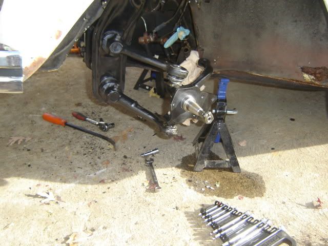

Then i found the tie rods don't fit the new spindle for the disk brakes so i need to replace them. Still a nice day to be wrenching on the car.
Anyone have any thoughts on trying to rebuild the calipers?

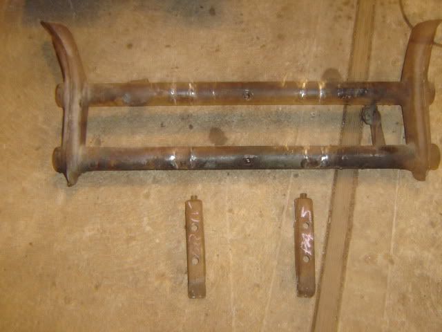

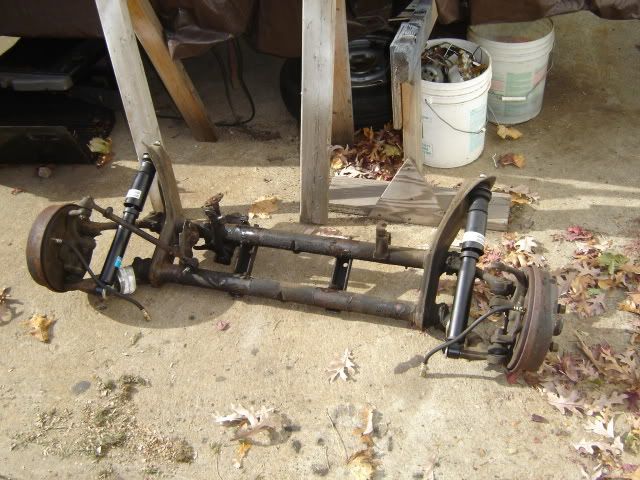

Here are some pics.
Old Beam

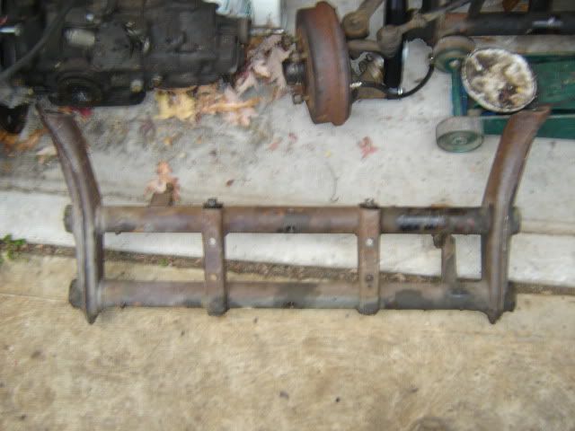

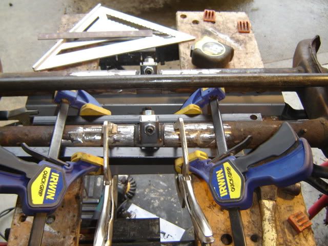

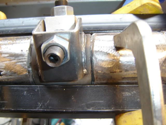

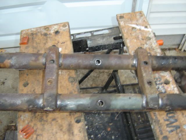

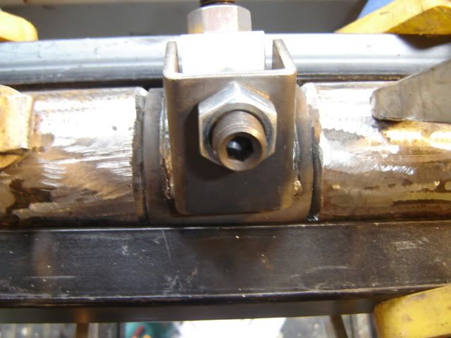

My plan is to take one of my other beams narrow it and add the adjusters.Glenn A wrote:That was narrowed 4" and had drop spindles with an adjustable beam. It also had 145s on 4 1/2" wheels. You can't get that low with a stock width. You should have narrowed yours!
Sweet. 3" would be a good number for you.Brown wrote:My plan is to take one of my other beams narrow it and add the adjusters.Glenn A wrote:That was narrowed 4" and had drop spindles with an adjustable beam. It also had 145s on 4 1/2" wheels. You can't get that low with a stock width. You should have narrowed yours!
