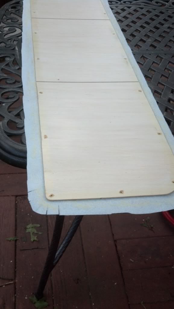

Got the rear and slider panels covered.
Some spray adhesive to hold in place then fan the corners to lay flat. Contact cement on the edges.
All covered. Going to let the glue set before i hang them with the studded clips.

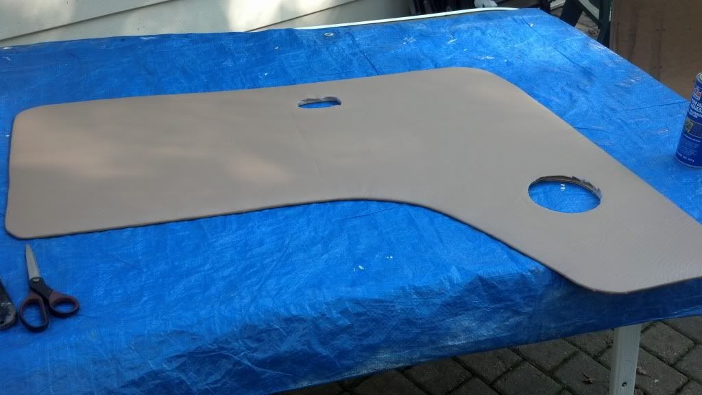

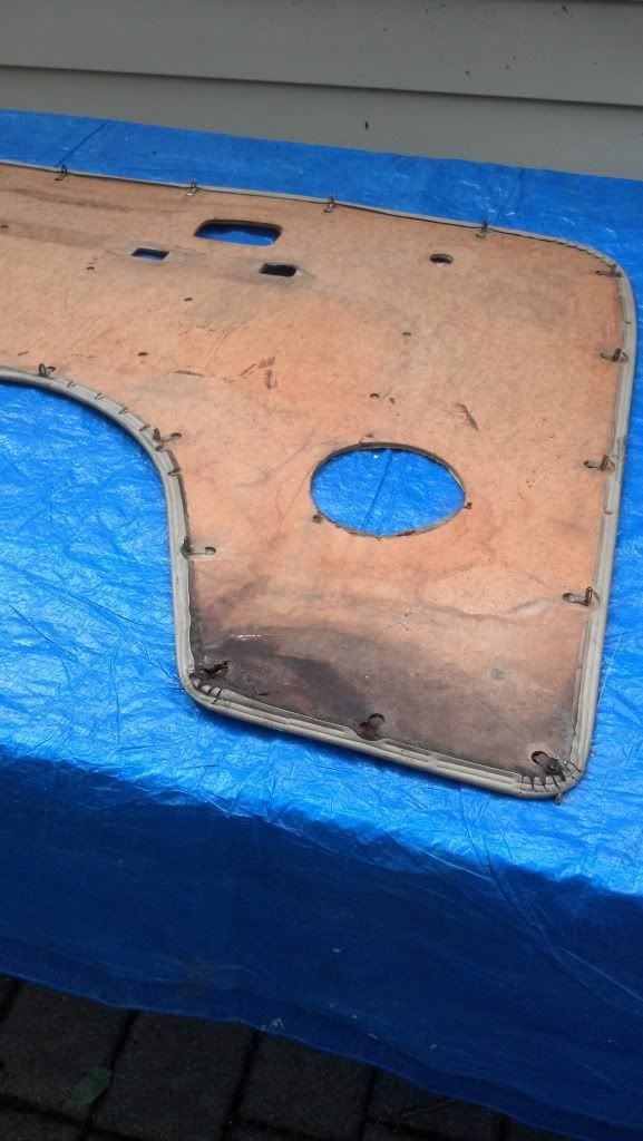

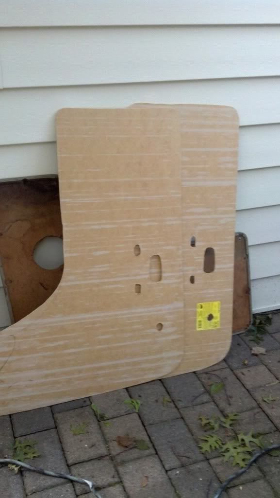

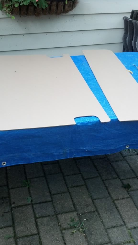

Cut out front door panels. Not much to salvage on the old ones.
New panels cut out and trimmed to fit. Will cover them in the am.

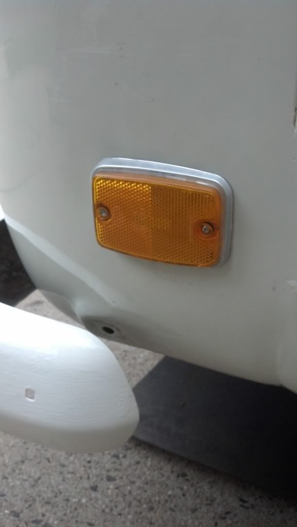

Got some rear flectors in my pickings so hung them up off the rear bumper. Can always use some extra coverage.

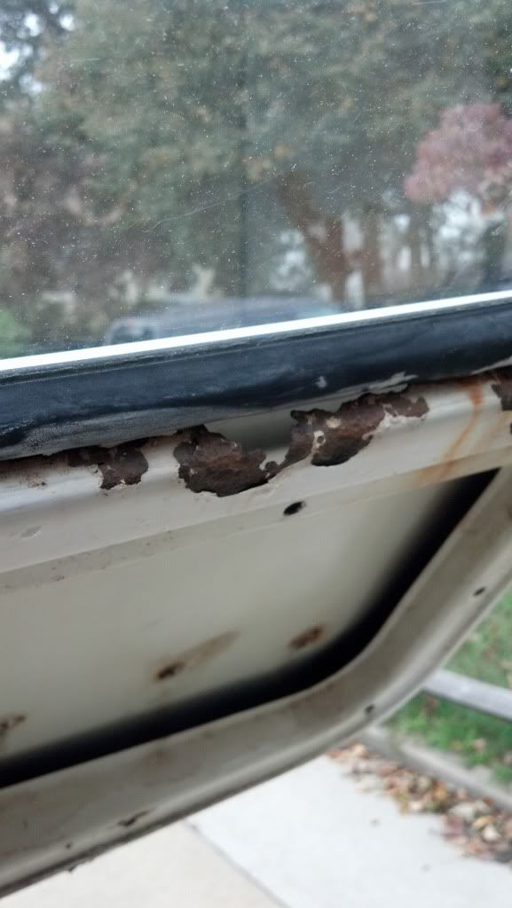

Not too happy about the rust on the bottom of the rear window. Cleaned it out with rust inhibitor and por15 it. Hope the new seal has something to grab.

Moving along on getting the door panels done.
Got the front panels covered in vinyl. I put a layer of foam under to give it some softness.

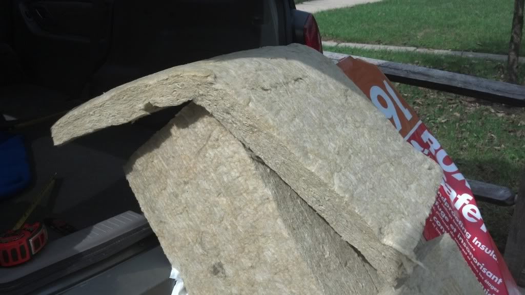

I biught a bag of roxul to insulate the slder and rear door. Heard about this stuff from Holmes vs Homes. Its a lava wool but no fiberglass.

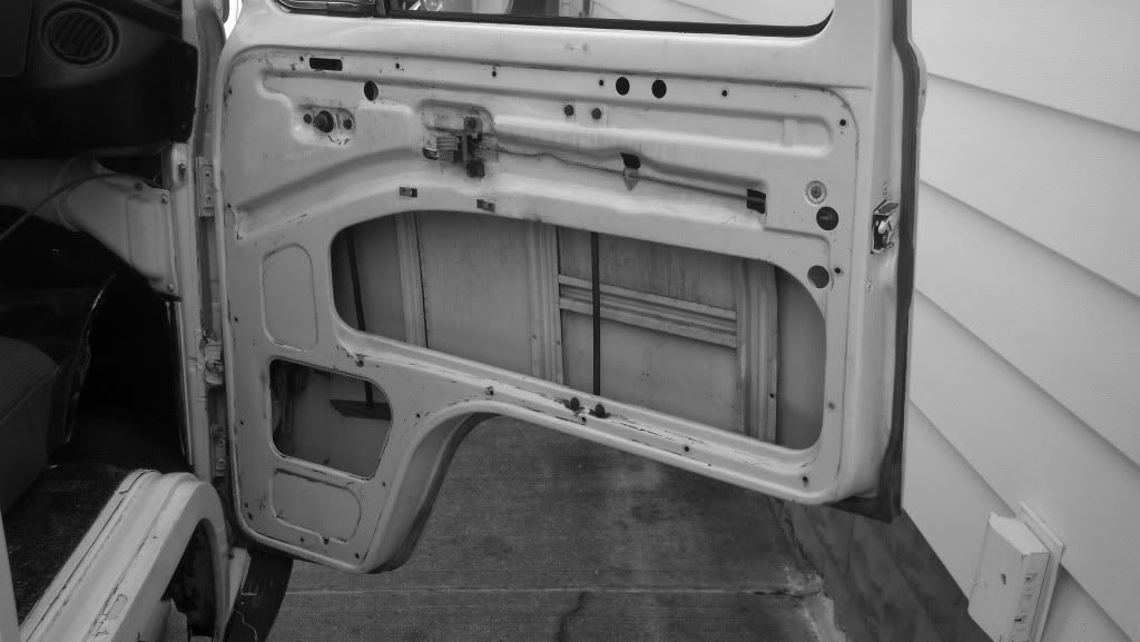

Its easy to work with and cuts like butter. Glued onto the door after i took off the old stuff.
Cleaned all the old glue off the door to get a fresh surface. Lots of old vapor barrier and dirt removed
New vapor barriers on so just need to add the final touched.

Im a little behind on my TV, does that insulation normally take place of the std faced roll r-19 and the like? How much more expensive is it?
Progress! Cool! Never heard of that insulation- is it a NY thing? Kinda like "Suffolk" laundry soap was?

The Safe N Sound is fire proofing and sound control used generally on interior walls with no R value. $42.63 for 60 sq ft at lowes( standard 2x4 wall, 24 on center, im sure 16 on center is cheaper) Roxul also makes Comfortbatt which has an R15 value for 2x4 walls 16 on center 35.98 for about 60sq ft at lowes. For exterior walls I would maintain using the craftfaced johns manville or certainteed products. Just my 2 cents and by the way great write up audrey! I always tune in to your updates.

good to know Matt and Audrey. I'm working on a project a home and want to dampen the sound of the new TV room from the bedrooms. This looks like a perfect fit.... better than the sound deading Sheet rock thats big dough!

Dont mean to derail, but yes roxul would be perfect for that or I've heard from carpenters Homasote board installed before sheetrock works well.
Roxul would be the perfect solution to minimize the tv noise. The 16" would go right between the floor joists.

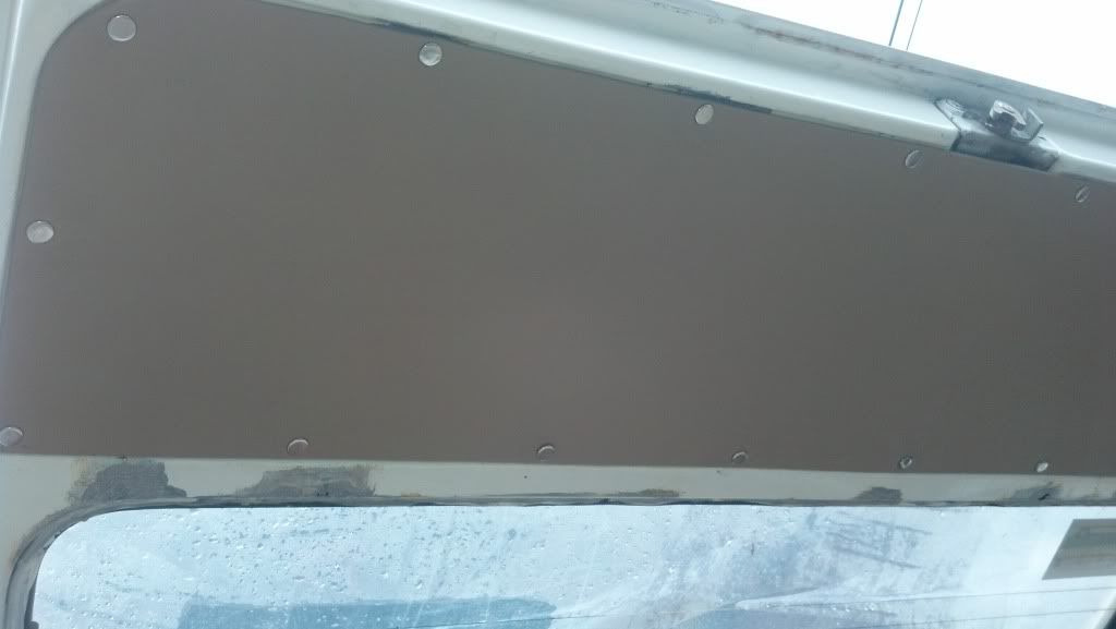

Finished the slider and rear hatch. Was a little tricky matching up the holes that had been predrilled but got it all worked out.
Slider with roxul installed.
Panel on. I was able to reuse most of the buttons but also ordered more. I am going to use this technique on the front panels.
Rear hatch door finished. Just needto get the new window seal installed and give it a coat of paint.

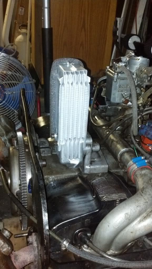

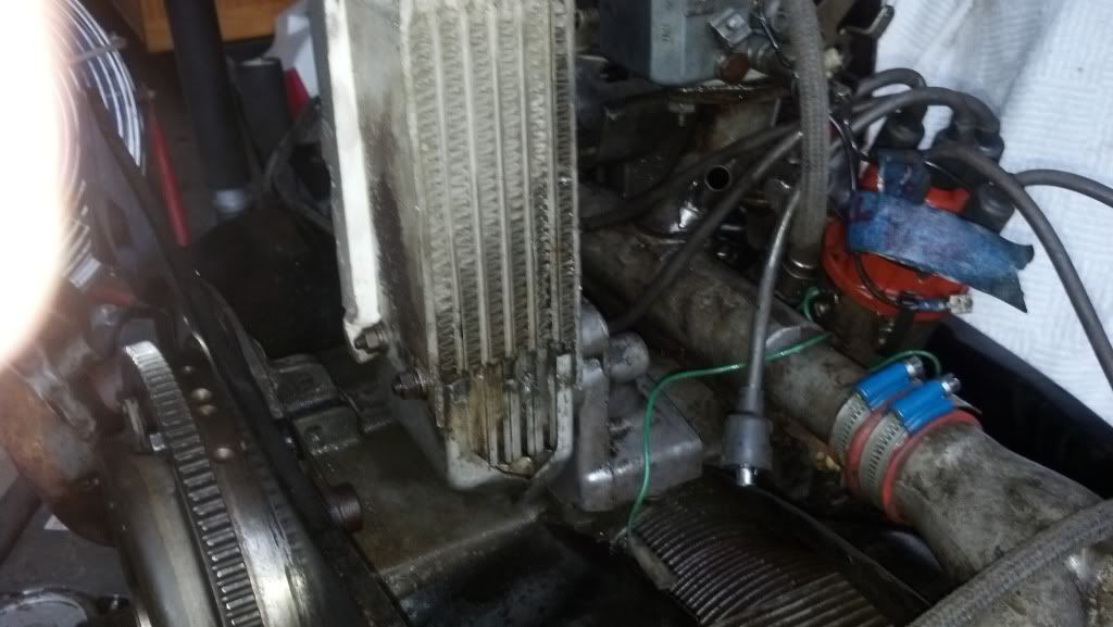

Picked up the new oil cooler and got it installed.
Hope this will be the end of this headache and oil everywhere.
Out with the old
In with the new
Engine needs a good wash down to get it looking sweet!

Was there a lot of oil inside the fan shroud ?
Tom wrote:Was there a lot of oil inside the fan shroud ?
I spent time cleaning the engine compartment and engine of oil. The housing for the cooler was oily but the place that seemed to be heavily covered were the louvers on the bottom on the shroud. Gave the inside of the dizzy a good wipe down too!.

Good news of the day. I checked the engine compartment after my ride to the beach and there was no sign of any oil misting from the cooler. The rear wall was dry and no oil leaking. Hope the new cooler solves this issue. :P
