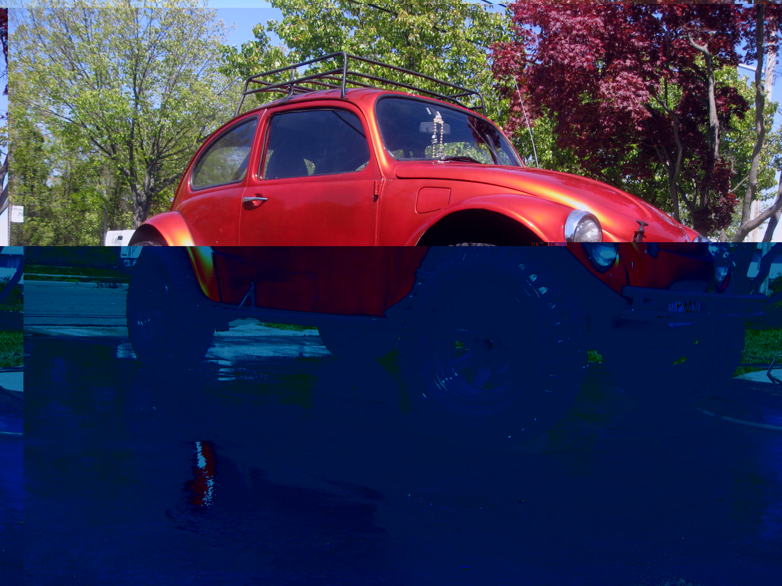

Its been quite some time I have posted on this car, but all for a good reason I guess. She was my winter VW and served me flawlessly. I have taken her to work and all errands whenever I dont have the little guy with me. No issues and have done nothing but change the oil. I used to help with some landscaping this weekend so I figured I give her a bath. Considering I painted this thing in my mothers garage almost 15 years ago, and its been outside everyday since..... shes holdng up quite well. Some rust starting on the bottom of the doors from the one piece windows ( dont do it if you are on the fence) and clogged drains, but overall..... running and looking ok. I will need to do some ball joints on it soon though. And the main seal still leaks some oil too.

Re: 69 baja
It's a work horse.
Posts: 1939
Re: 69 baja
Glenn wrote:It's a work horse.
exactly......
