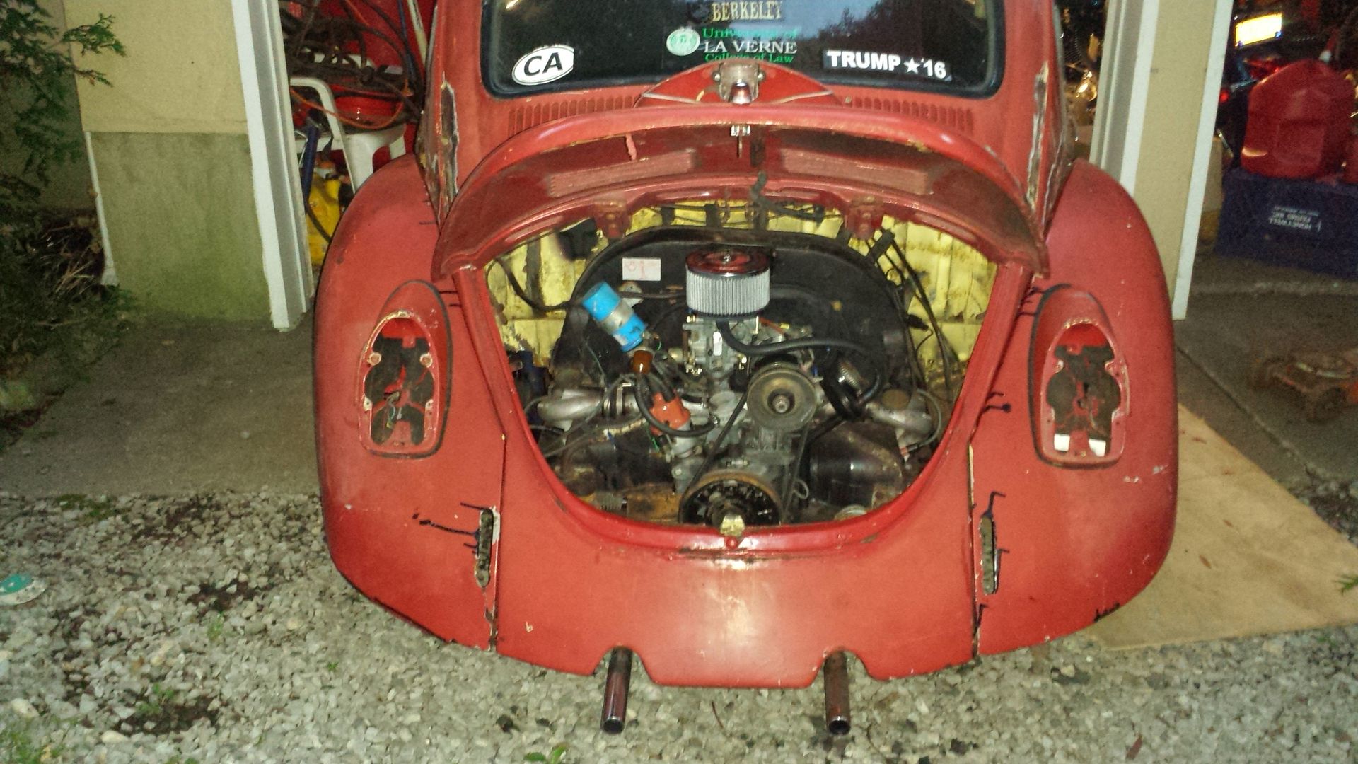

ive had good luck with rustolyem in the past. i think alot of people are miss using POR its made to paint on rusted metal and alot of people are using it on new metal where it gets no Bite, i have a question is there a seal behind the crank pulley ,she starting to mark her spot after running a few minutes
your crank case breathing alright?
excessive pressure is sometimes the culprit in a leak behind the crank.
Posts: 1939
elrockk wrote: i have a question is there a seal behind the crank pulley
No seal behind the stock crack pulley. It uses a that concave washer ( not visible when engine is together) and mainly the force created form the spiral grooves on the pulley to keep the oil 'in'.
yeah i think i still have the breather taped closed from when i power washed it ill try that tomorrow. thanks guys

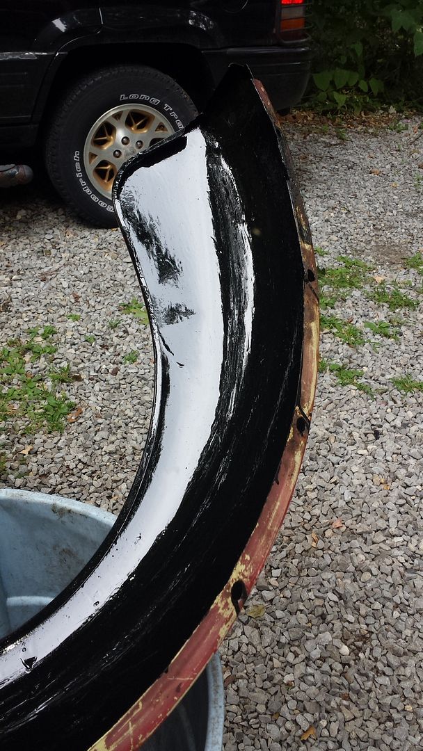

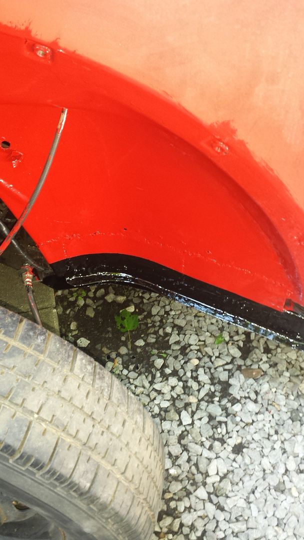

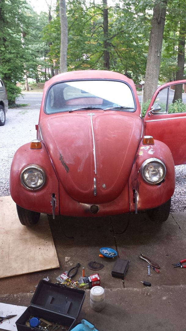

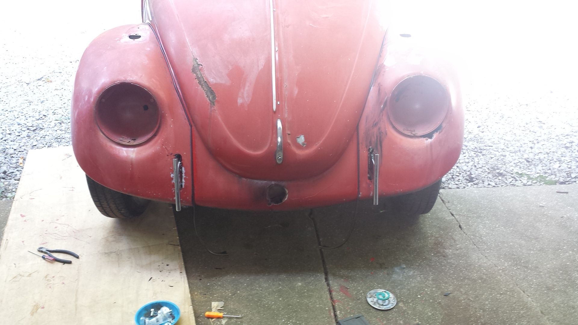

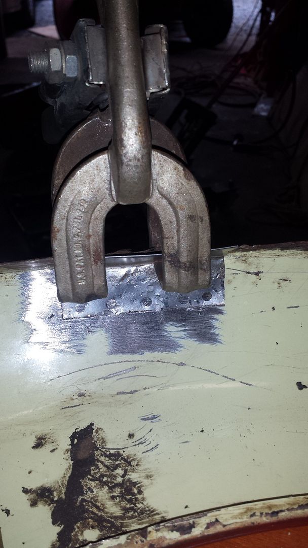

rigging fender for install Image Image Image got a coat of rustolium on the inner fenders Image and got the rear fenders on loose
rear fenders on loose letting the beading unroll a bit tonight Image gonna get front fenders on tomorrow Image
Kickin' it out! Good to see others making progress too!

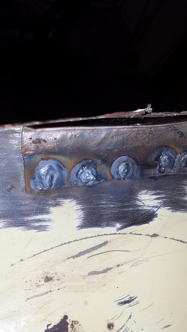

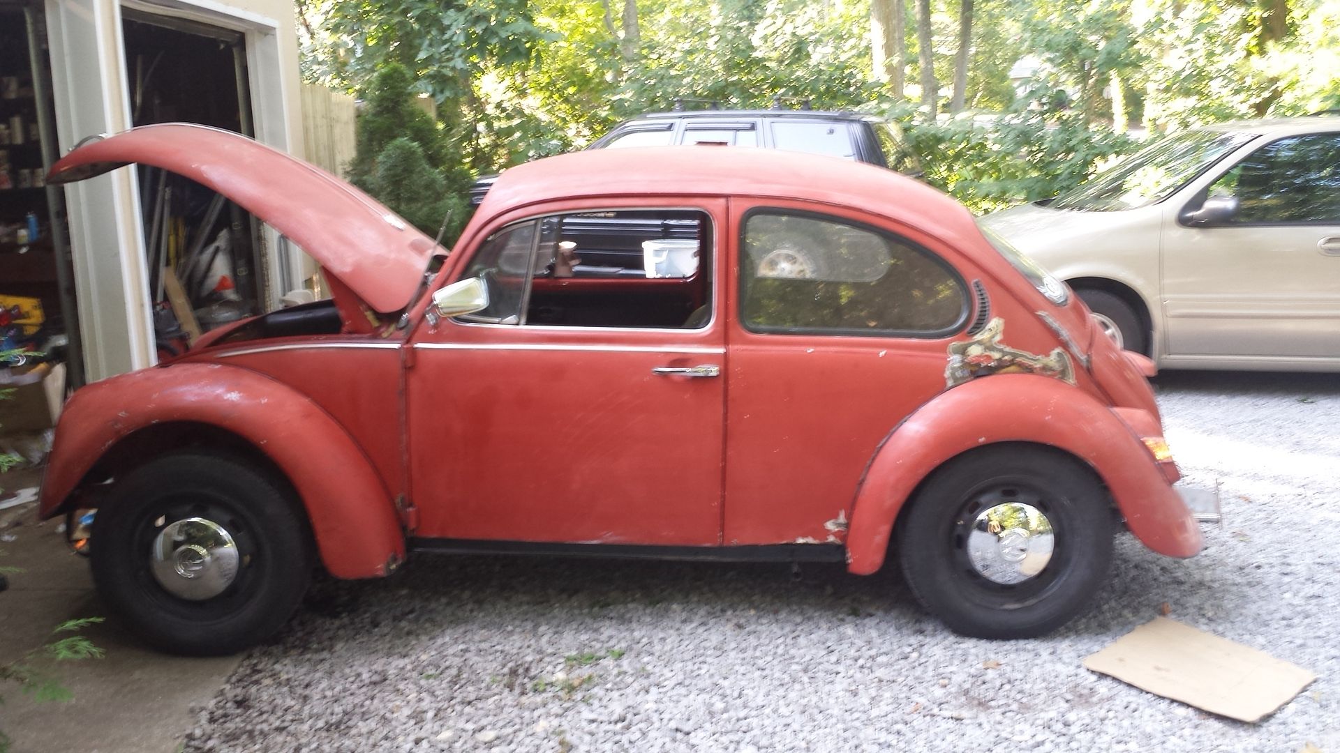

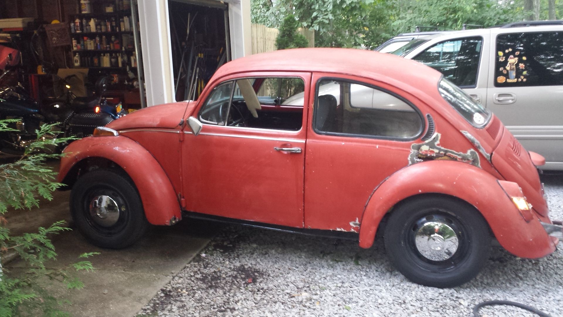

made a clean line in the paint to take the eye off my crappy welds Image got front and rear fenders installed Image apparently ive got 2 different fenders in the front and 2 left side :lol: turn signal lights Image but i got all the lights installed and mini bumbers

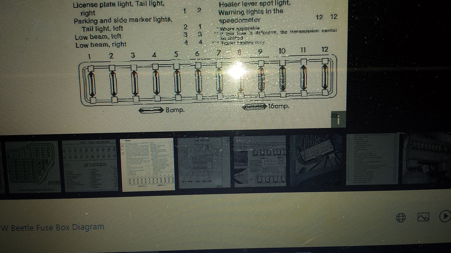

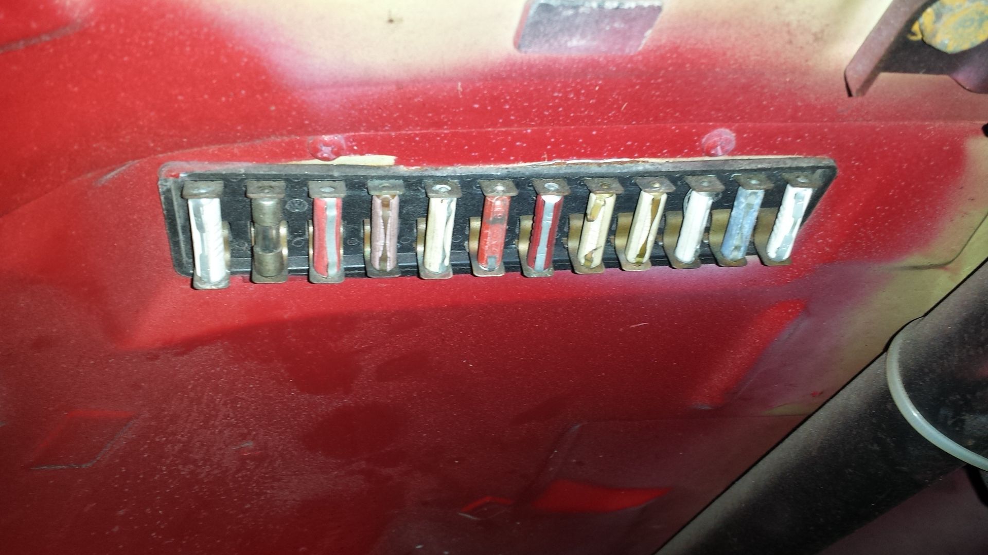

i have 2 questions matbe you guys can help Image this is a picture of the fuse panel of a 1971 beetle i think 10 / 8 amp fuses and 2 / 16 in positions 9/10 this iswhat i got Image does anyone know if that diagram is correct for a 71 standard beetle? And which of the 2 fenders is correct for my front im hoping the passenger as its smaler
iirc there's 12 posts & 10 post fuse boxes & all 12s wire the same, all 10 post boxes wire the same
Posts: 1939
elrockk wrote:i have 2 questions matbe you guys can help Image
Looks like there was a change mid 71.... depending on the VIN. See attached
http://www.thesamba.com/vw/archives/inf ... _fixed.jpg
http://www.thesamba.com/vw/archives/inf ... per_71.jpg
thanks the fixed 0ne is what i have. replaced them all as per that diagram no smoke got somebulbs out wiil work on that tomorrow .signed up for insurance with Haggertys $181a year looks like license plates next week

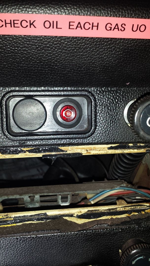

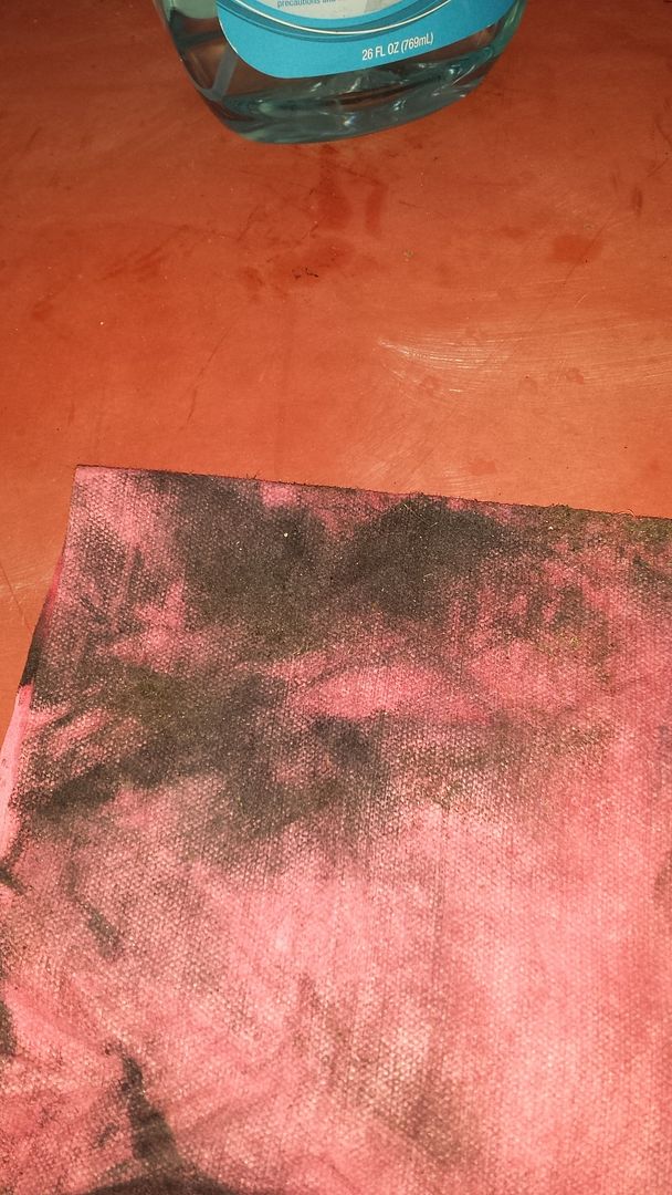

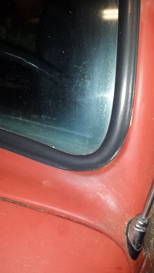

so tonight i figured i would clean the windows the car was last on the road in 2009 Image i could feel the chunks coming offthe glass is this smokey looking stuff fixable? Image and what does this button do? Image
Posts: 1426
I've found a great way to get windows clean with that kind of grime is with some simple green and a razor. Gently scrape the glass while using the simple green as a lubricant and you'll be surprised how clean they come.
The haze in the window is not fixable, shy of replacement. But it's not a hard thing to do, even easier with two people and twenty minutes.
As for the button, it's the brake circuit test. Also will will you if one of the brake circuits go bad. IIRC, pushing the button should make it illuminate, so as to allow you to test it and know the light works. If it comes on on its own one of the brake circuits failed.

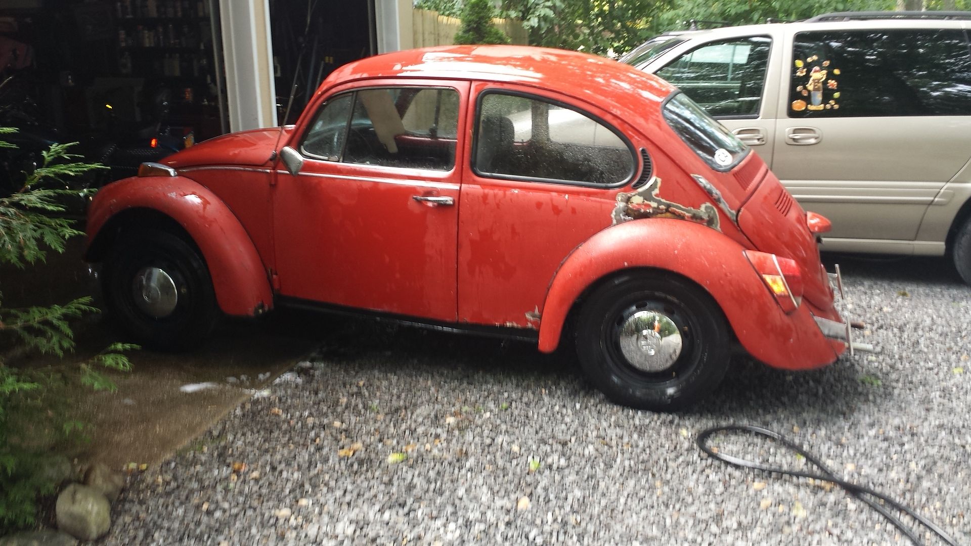

yeah last night i cleaned them 2 times with windex and still had stuff on the window. so today i used some formula 409 which got a lot more dirt off but still not clean. got some BonAmi and scrubed the windows much better but still some stains that wont leave Image gave it its first wash since 2009 Image looking better at least its clean to the touch.then started chasing some inop bulbs and narrowed down the problems to the turn signal switch and some shoddy previus repairs Image so tonight ill rewatch somebug me videos i think i remember him doing steering colums

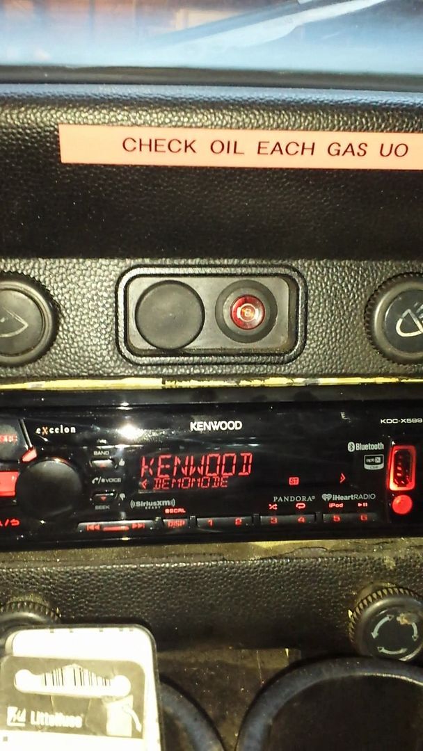

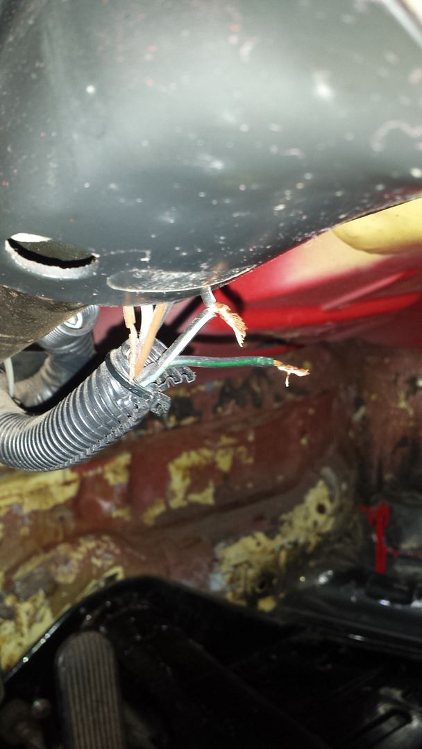

so i took the turn signal switch out to repair the twisted wire connections and found out there 5 or so wires missing.so ill order a new one and figure out where the wires go. while i had the steering wheel off i thought it would be a got time to open up the radio hole and install the radio i got for christmas Image not bad sound for 1 45 year old speaker. i got 4 new ones just got to figure out where im putting them.
