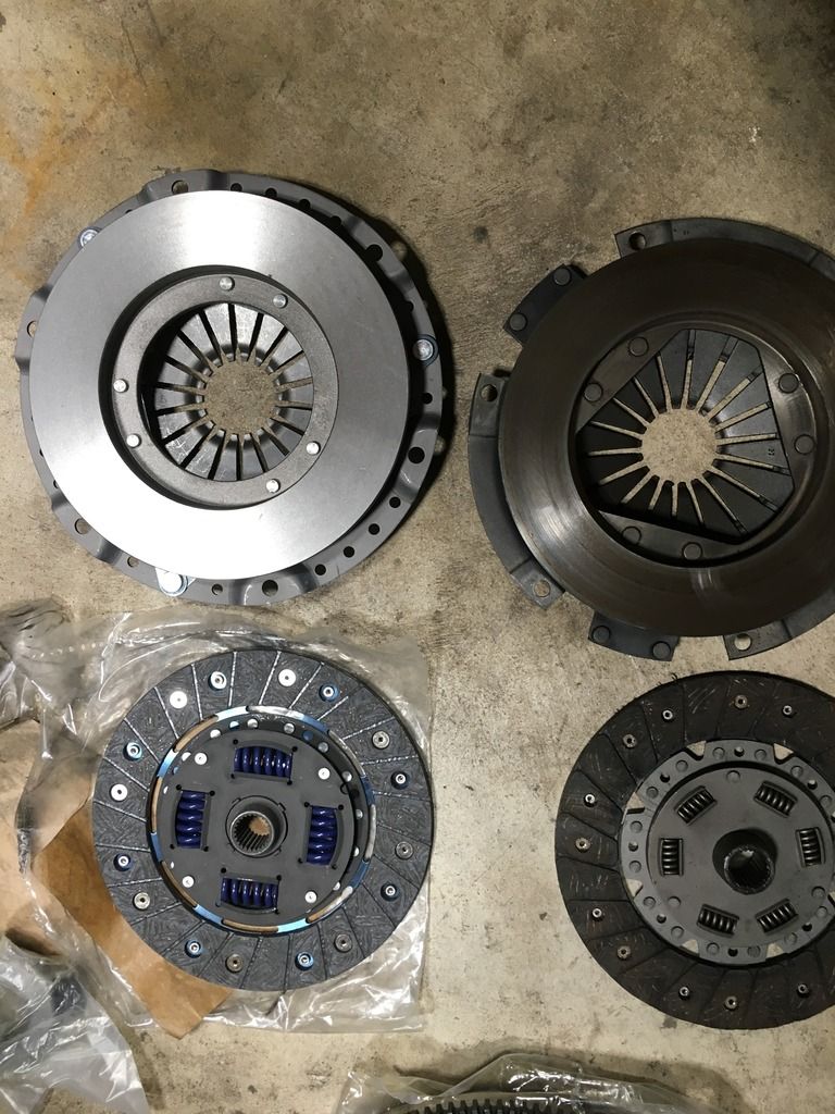

Paused from other pressing matters and house work to get the bus shifting issue sorted for the upcoming weeks that I want to get the bus to.

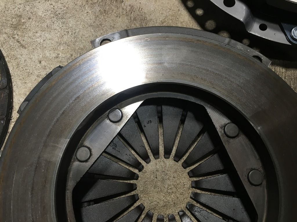

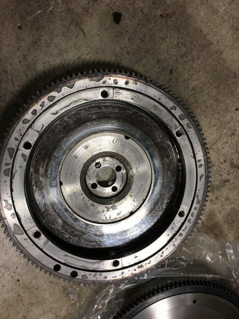

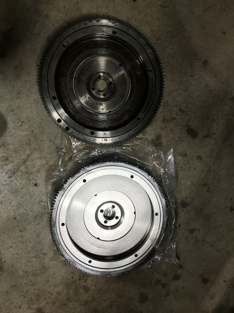

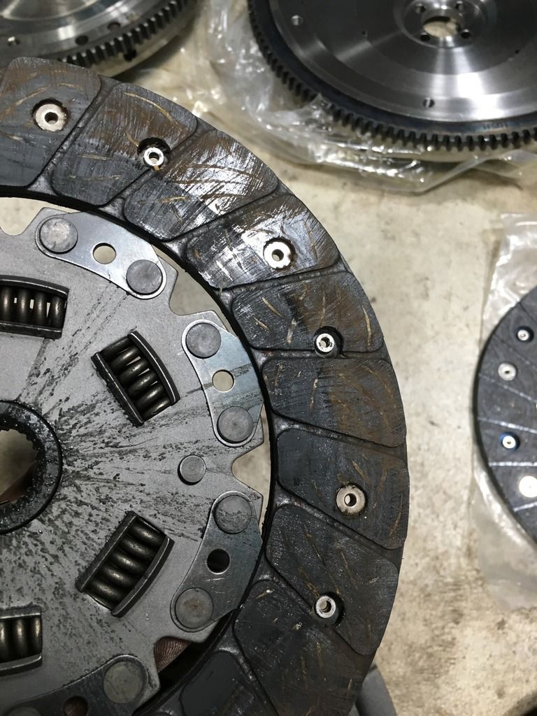

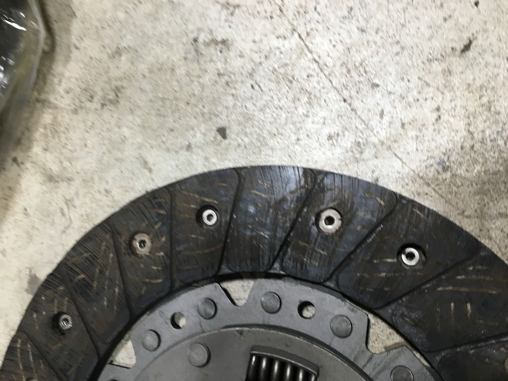

If you recall, gear selection was very hard while the engine running, but like butter with the engine off. Clutch adjustment was limited as too tight, no gear selection, and backed off, it would slip. I replaced the disk last time motor was out. People suggested it was the linkage, but I think it was a worn, flywheel.
Pulled the engine and flywheel Wed night. Discoloration and shinieness tell a bad story. Its also interesting that the disk seems to be only grabbing part of the flywheel.
Took it for a test drive around the block, seems 100% better. Let me button it all up and get some miles on this this weekend.

Postby Big_kid » Fri Jul 22, 2016 6:28 pm
Dished flywheel? What else could possibly cause that?

Big_kid wrote:Dished flywheel? What else could possibly cause that?
Im not sure.... I think it was cut too deeply at one time or another. Maybe a bad cut..... or just simply worn. Whatever it is that flywheel is now in route to becoming a kia.
